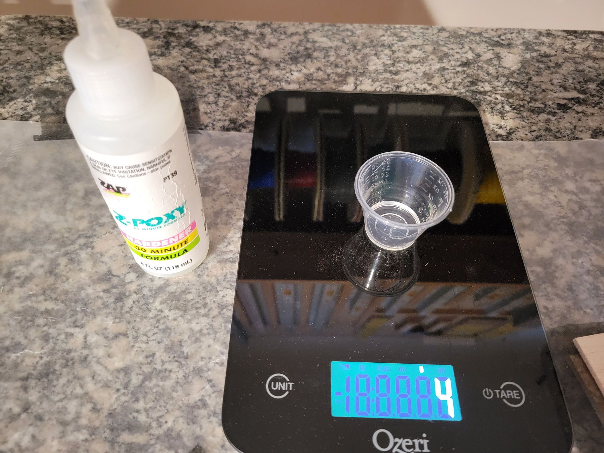

VincentJ December 16, 2024
I thought I would take the time to explain how I ensure my ratios between the Resin and Hardener are correct. You certainly can use the markings on the side of mixing cups, but they are cumbersome and hard to read. For better accuracy, I use a scale to measure out the exact amount of each part. Here I've drawn 4 grams of Hardener in the mixing cup.
