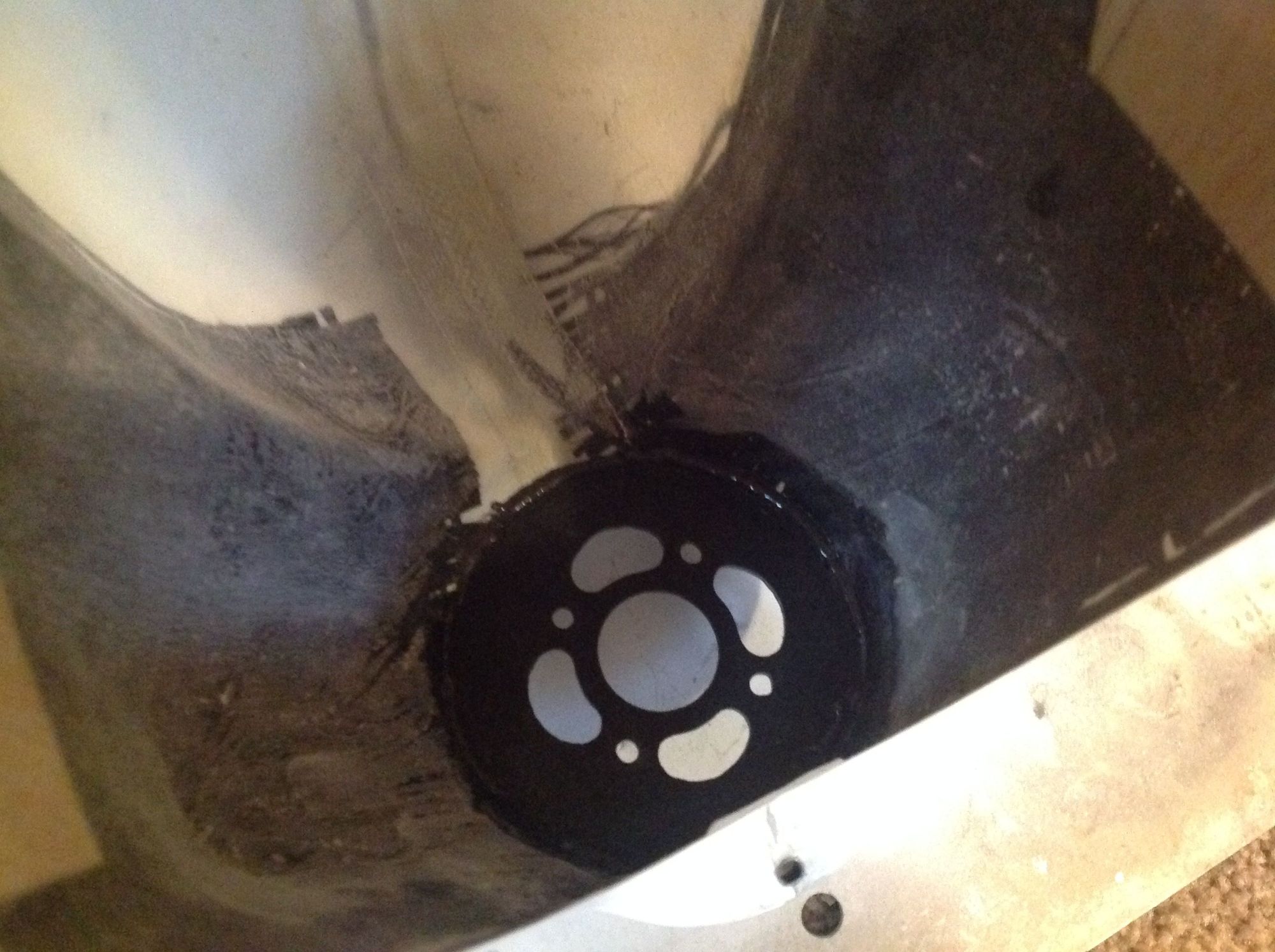

The first step was to tack glue the mount into the nose. For this I secure the mount to the motor and get it onto place using a spinner backplate to align the motor to match the nosering which has the correct thrust angles molded in.
